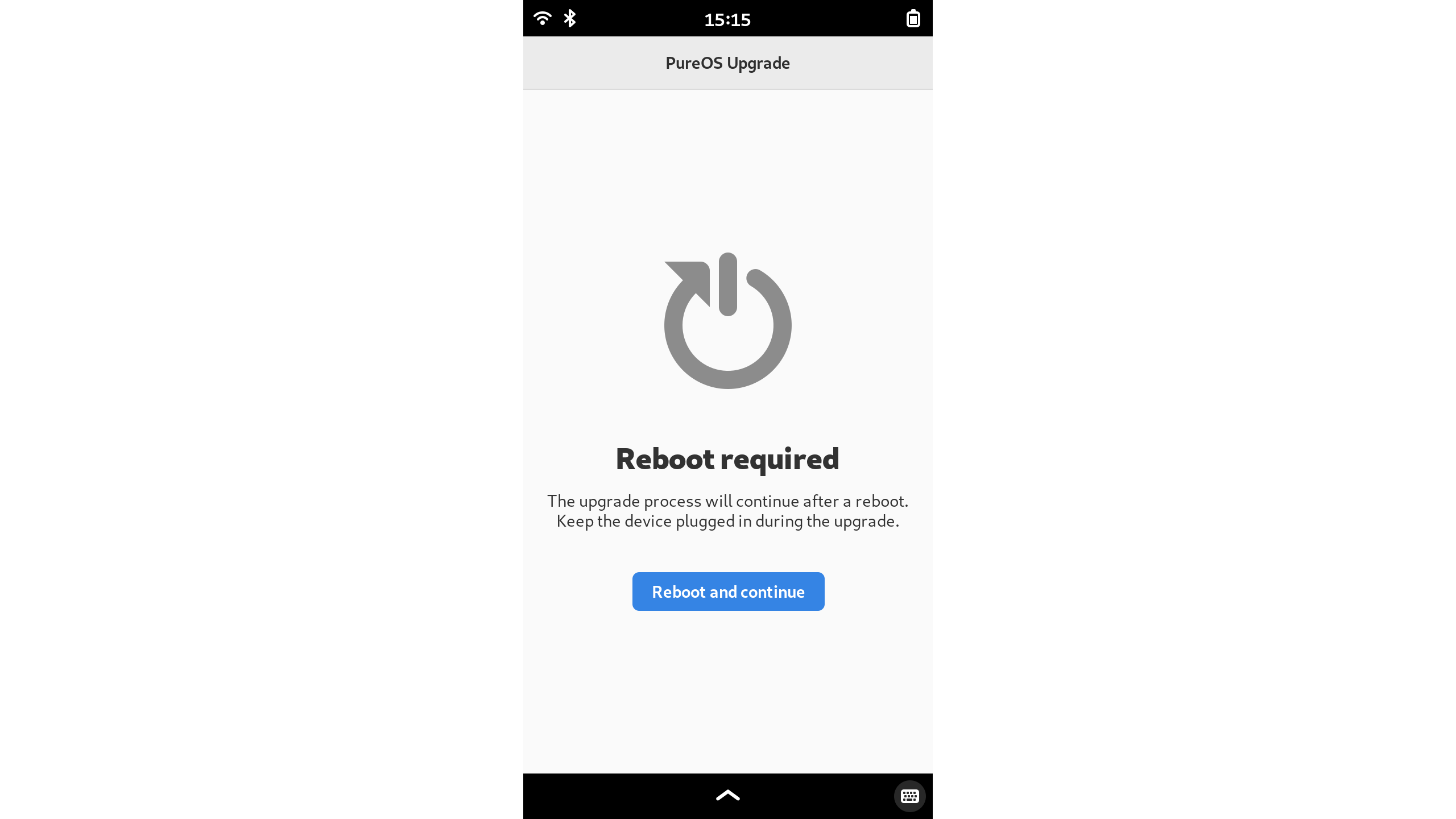

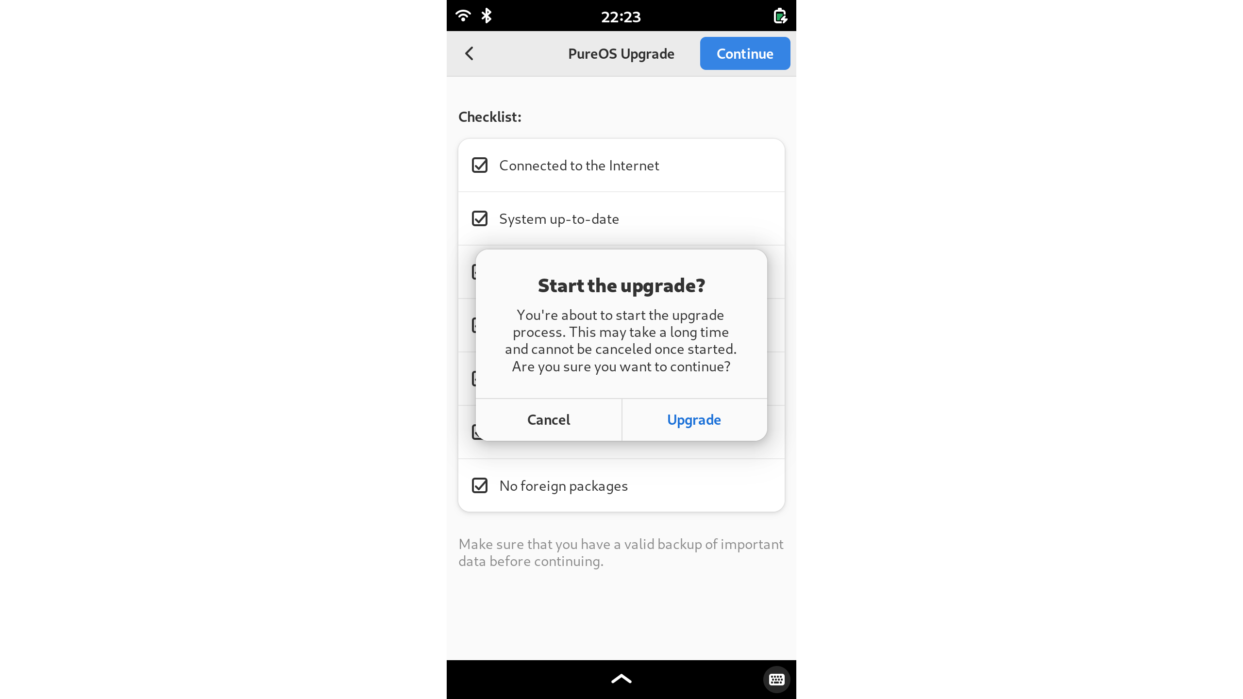

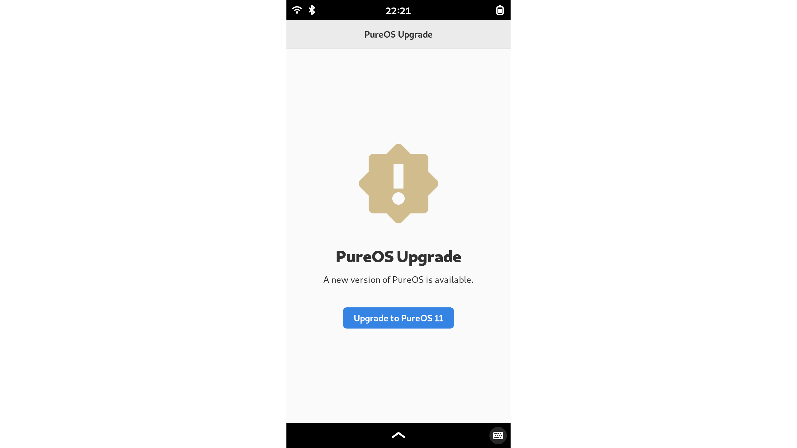

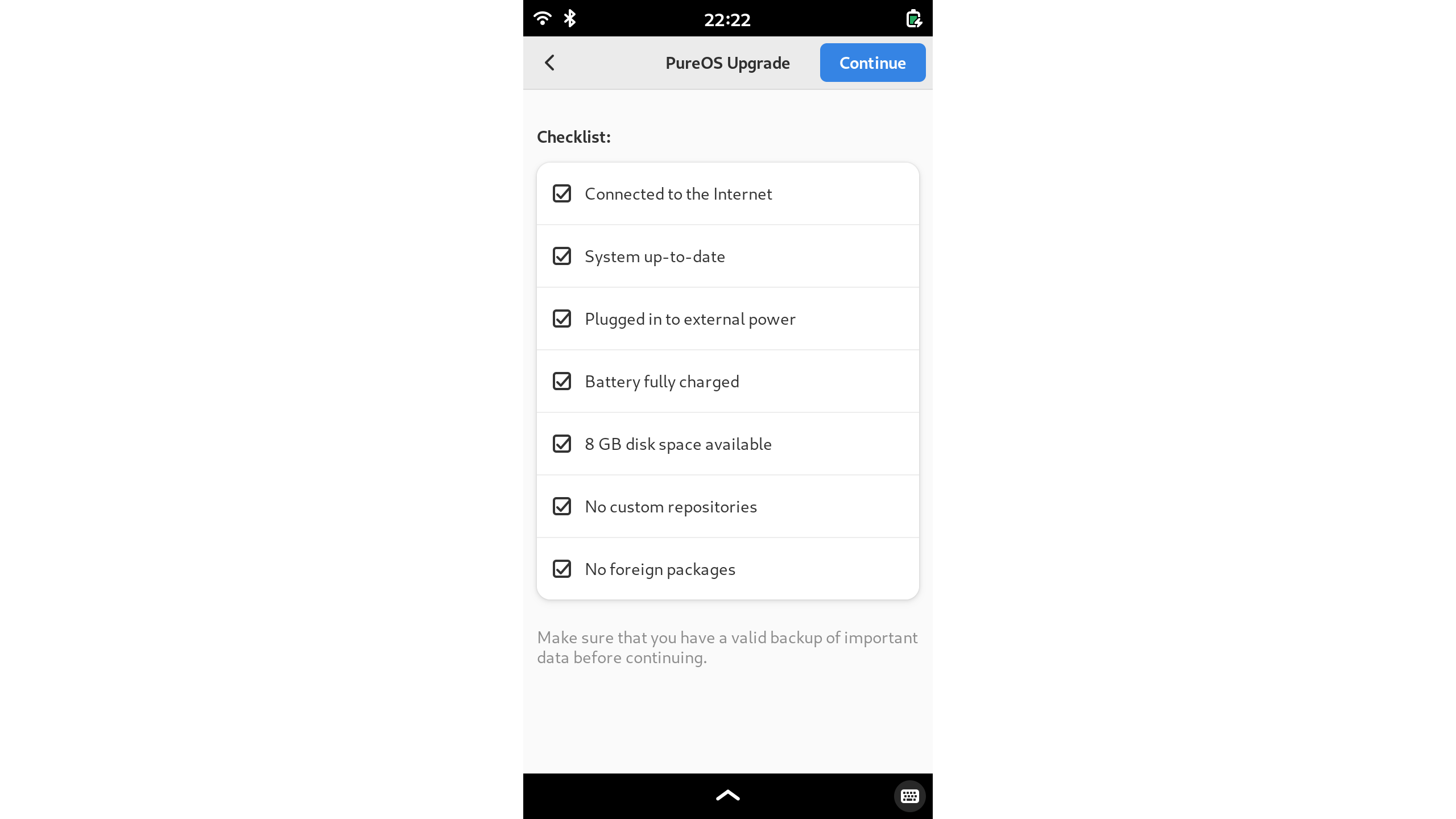

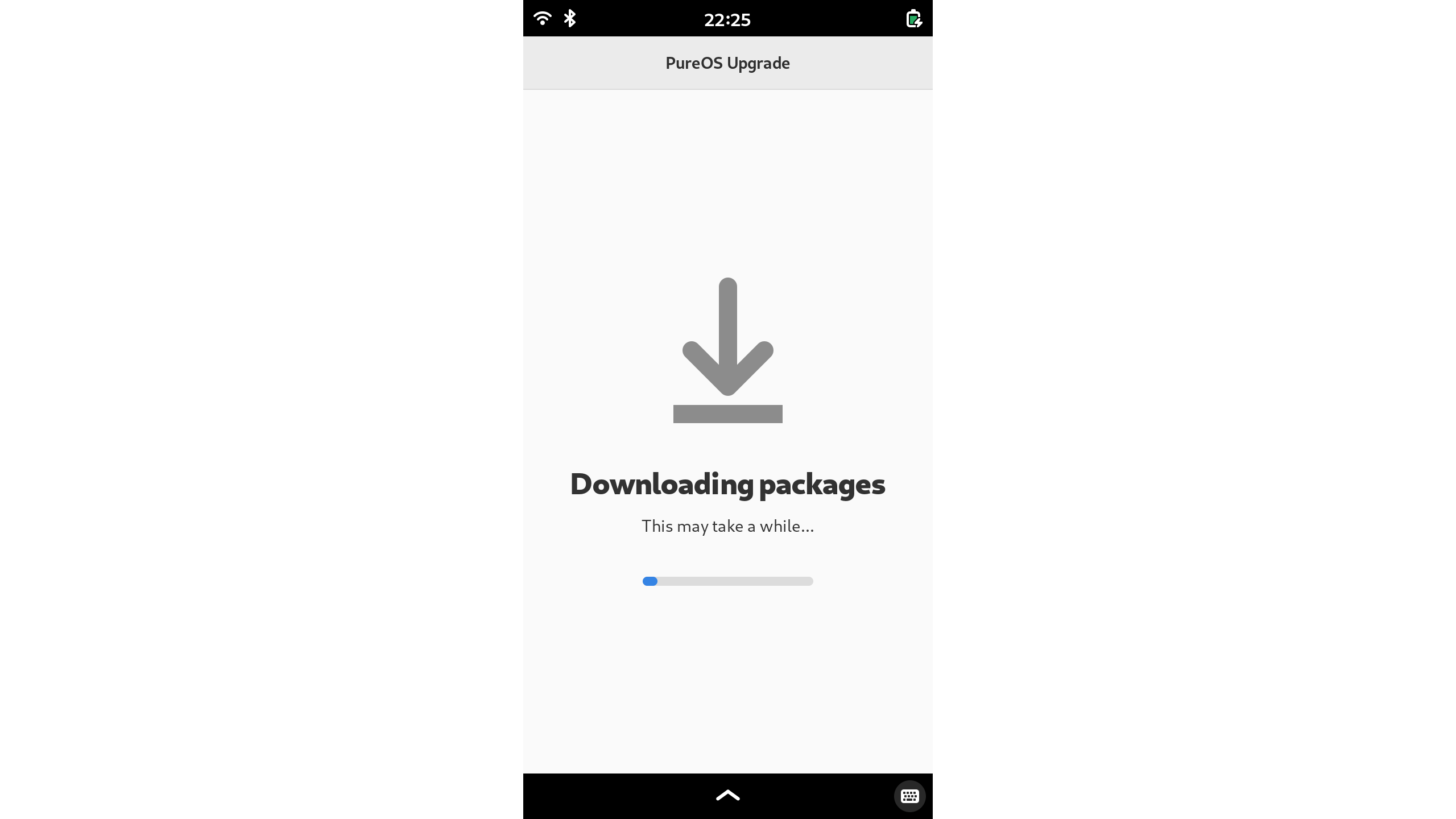

We include a graphical tool called PureOS Upgrade to help users upgrade their system between major releases.
To upgrade to a newer PureOS release:
  1. Launch the PureOS Upgrade application.
    Icon of the PureOS Upgrade application.
  2. Once the application launches, click on the “Upgrade to PureOS NN” button, where “NN” is the available PureOS version number.
    Screenshot of the PureOS Upgrade application informing the user that a new version is available.
  3. There is a checklist of items to complete before upgrading is possible. In many cases, all of them will pass and you can click the “Continue” button.
    Screenshot of the PureOS Upgrade application checklist requirements.
    Note
    If you see an error about foreign packages, please remove them from your system before proceeding.
    Tip
    You can bypass the checklist by opening the application from the terminal: pureos-upgrade --force. Please be warned that this may cause issues with unsupported software.
  4. There is a confirmation prompt before the upgrade starts. Please review the notice and click the “Upgrade” button when you are ready.
    Screenshot of the PureOS Upgrade application warning the user about the potential of a long upgrade time.

  6. Once the upgrade has started, do not power off your device. It will refresh the package lists again and then download the upgrade.
    Screenshot of the PureOS Upgrade application downloading packages.
  7. When it has finished downloading the upgrade, it will ask you to restart and install the upgrade.
    Screenshot of the PureOS Upgrade application asking to restart the device to complete the upgrade.
