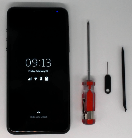

Materials#
  1. 1x #0 Phillips-head screwdriver
  2. 1x SIM tray removal tool
  3. 1x plastic pick or spudger
L5 disassembly materials

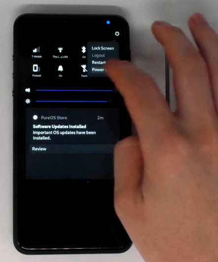

  1. Completely power down the device.
    Powering off the L5

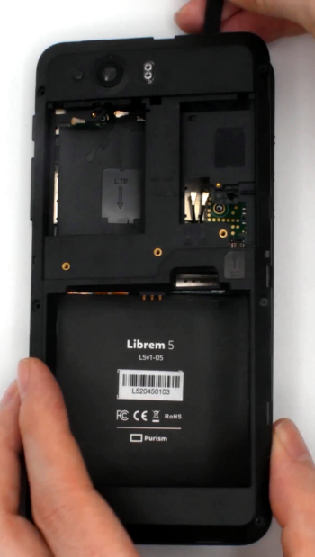

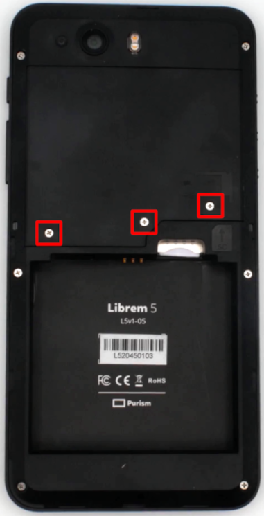

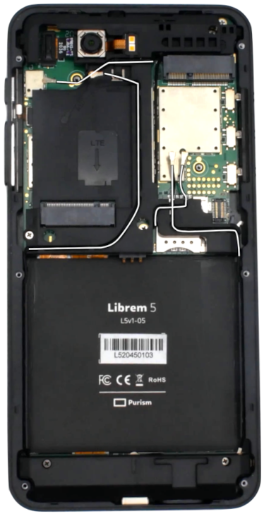

  4. Remove 3 screws holding the modem cover.
    Note
    These screws are shorter than the rest of the screws, so keep them separate.
    Modem cover screw locations

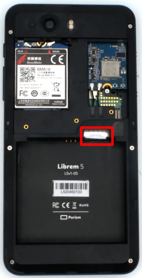

  5. Remove the SIM tray.
  6. If you have a smart card installed, remove it now.
  7. Remove the WWAN module.
  8. Remove the Wi-Fi/Bluetooth module.

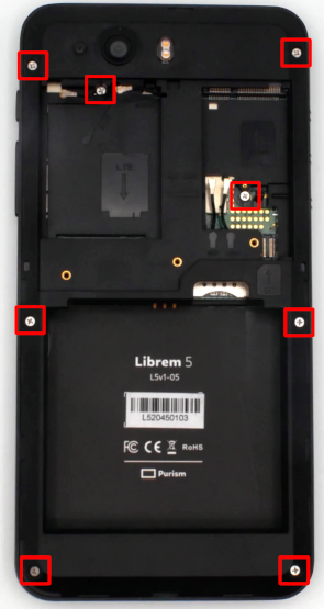

  9. Remove 8 screws retaining the internal frame.
    L5 internal frame screw locations

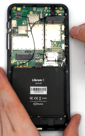

  10. Use a plastic pick or spudger to release several friction clips around the outside border of the frame.
    L5 internal frame removal
  11. Carefully pull the antenna cables from the plastic frame.

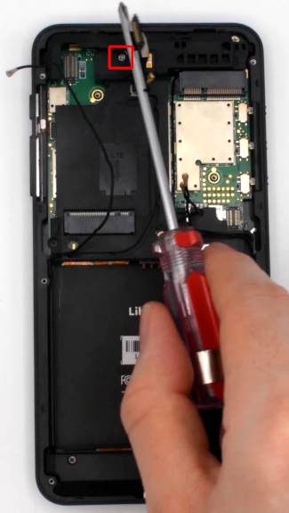

  13. Unplug the main camera and remove the screw hidden by FPC.
    L5 screw hidden near camera

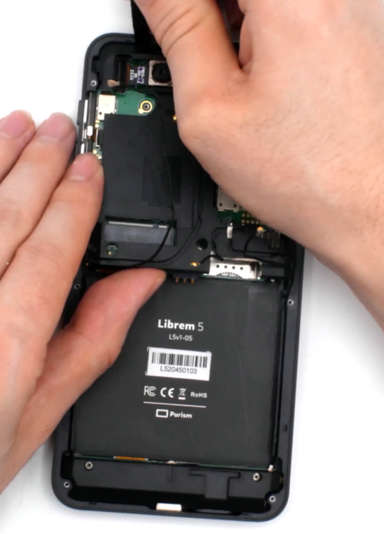

  14. The center frame can now be removed. Use a plastic pick or spudger to remove 2 friction clips at the top left and right of the frame.
    L5 center frame removal

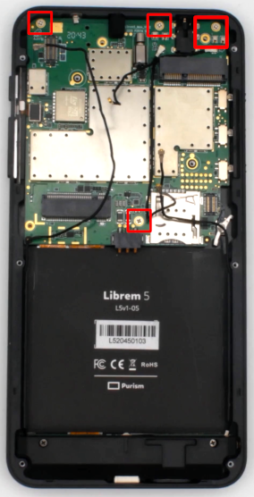

  15. Remove PCB screws.
    Caution
    1. Be careful about screw lengths and keep the case screws and PCB screws separate. Using a long case screw in a PCB screw hole can damage the screen.
    2. The 3 screws at the top connect the antennas, so do not forget to reinstall them during reassembly.
    L5 PCB screw locations

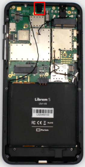

  16. Carefully remove the microphone cover and store it in a safe place. It is easily lost.

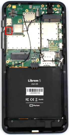

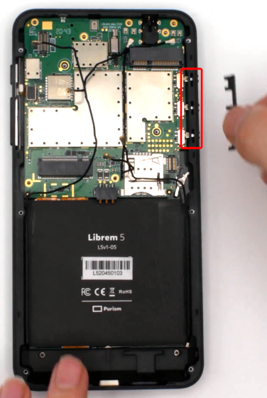

  17. Gently pull the hardware kill switch alignment tab up and out of the frame.
    L5 HKS alignment tab removal
  18. Remove the 3 hardware kill switches.
    L5 HKS removal

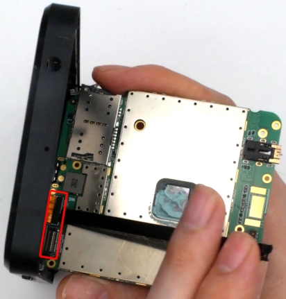

  20. Lift the PCB out until you can see the Display and USB-C FPC cables.
    Caution
    When removing the PCB be careful of the spring clip against the frame. This spring clip is part of the GNSS antenna assembly. GPS reception will become practically nonexistent if this spring clip breaks off.
    L5 GNSS spring clip location

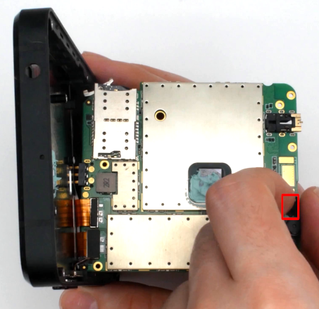

    Caution
    There is a cover over the proximity sensor that is easy to lose. Put it in a safe place. If the device is reassembled without this cover, the proximity sensor will trigger automatically, and would need to be disabled.
    L5 proximity sensor cover location

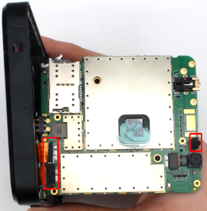

  21. Carefully disconnect the USB C and Display FPC cables.
    L5 USB C and display FPC cable location
    The remainder of the PCB can be removed after unplugging the final two FPC cables.

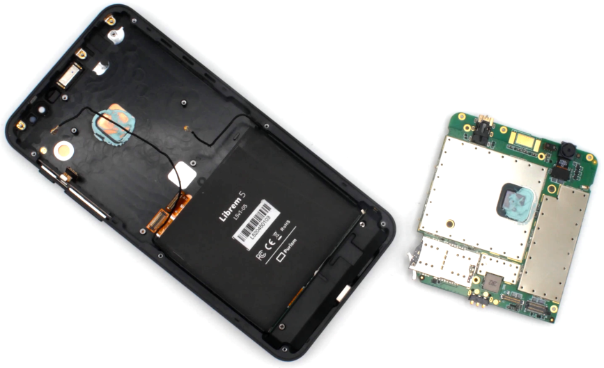

    L5 PCB removed

Follow this procedure in reverse order to reassemble the device. If the thermal paste looks satisfactory, begin by reattaching the PCB to the FPC cables and reattaching the proximity sensor cover.
L5 USB C & display FPC, proximity sensor cover reassembly
