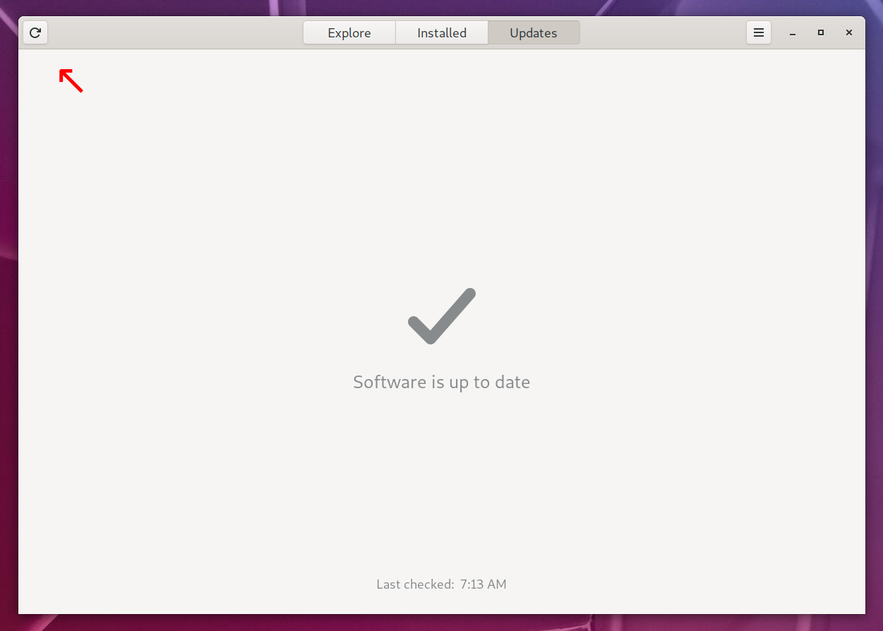

  5. Navigate to the Updates tab and click the icon in the upper-left corner.
    Refreshing the software updates page in Software
You can now use the Software app to install Free/Libre and Open Source Software (FLOSS) apps from Flathub.

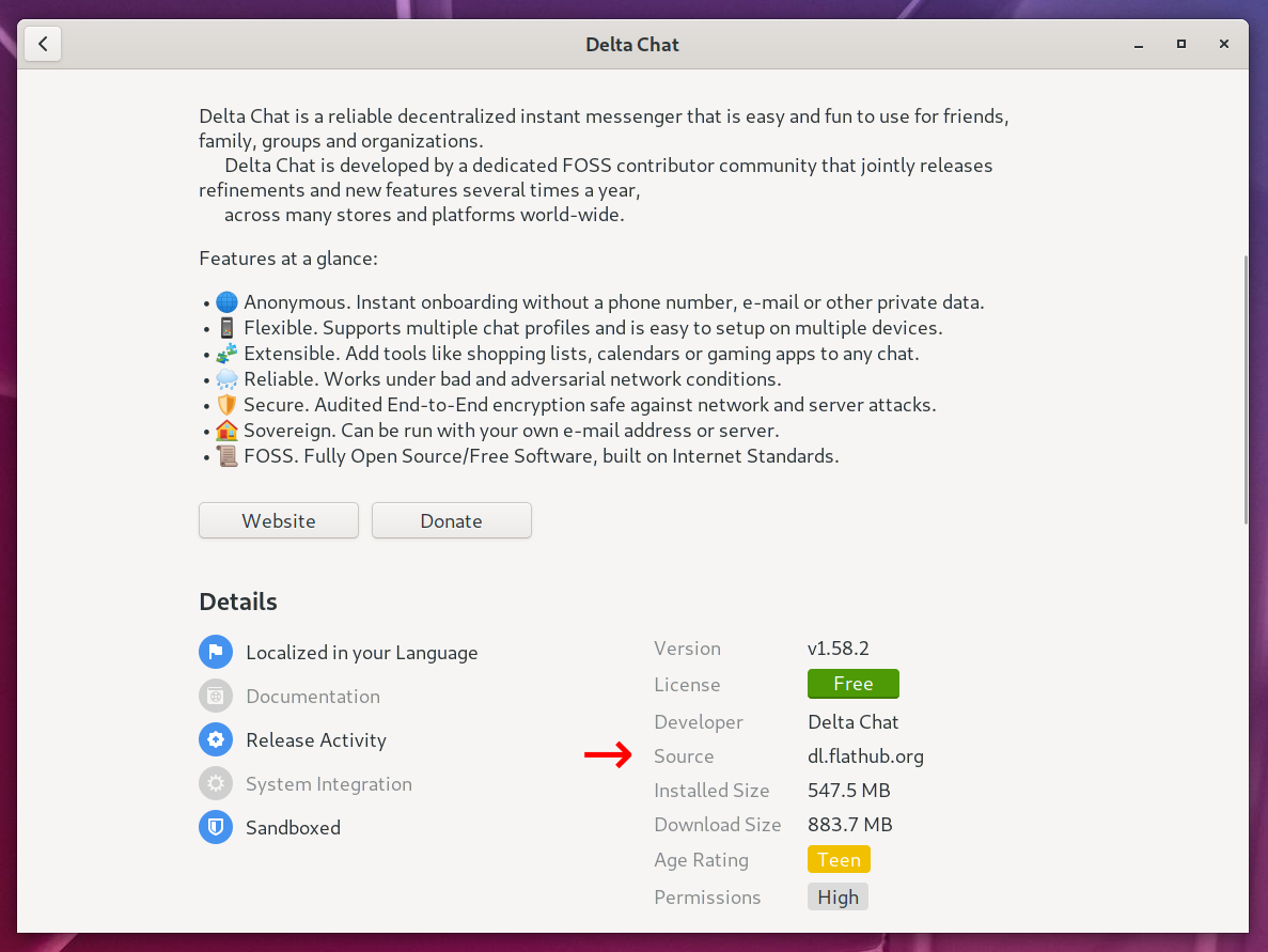

The Software application may list applications from several software sources. To determine the software source repository, scroll down to the Details section in the application details page. A Flatpak application installed from Flathub will contain flathub.org as its Source.
Determine the source repository for a package shown in the Software application
