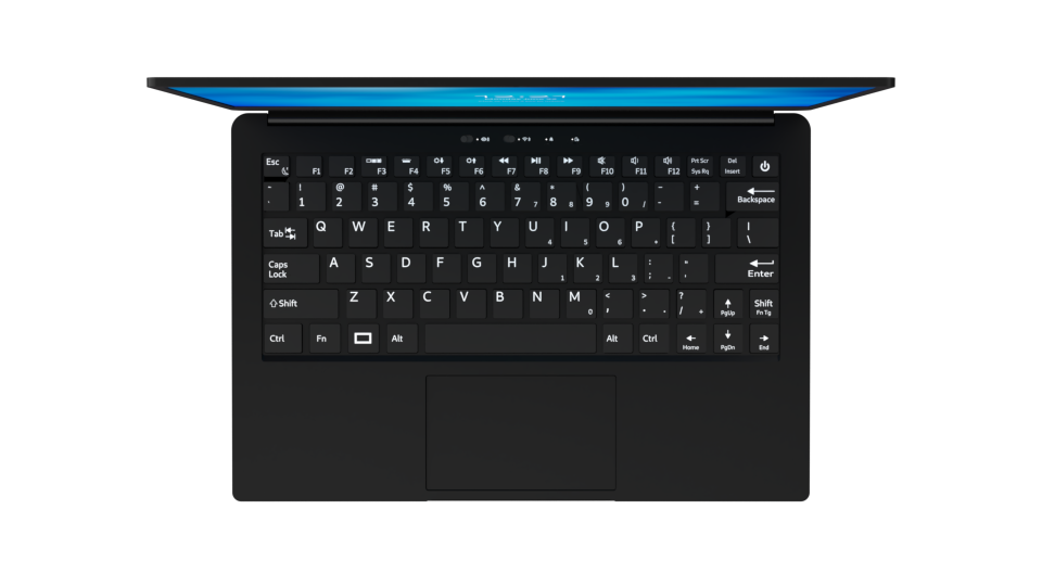

The keyboard features a dimmable white LED backlight. The touchpad is a I2C HID-compliant input device with one hardware push button (pushing the lower edge).

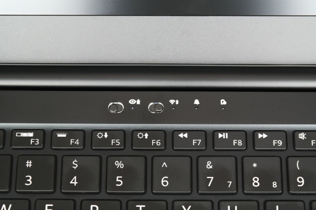

From left to right:
  • Hardware kill switch for camera and microphones (internal and external microphones will be cut off)
  • White LED indicator for cam/mic kill switch, LED on=cam/mic on, LED off=killed
  • Hardware kill switch for Wi-Fi / Bluetooth
    • This severs power to the Wi-Fi / Bluetooth M.2 slot and enables the #DISABLE signal on the M.2 slot
  • White LED indicator for Wi-Fi / Bluetooth, LED on=Wi-Fi/BT active, LED off=killed
  • Software controllable notification LED, red / green / blue
  • Power state LED, same states as the outside power state LED:
