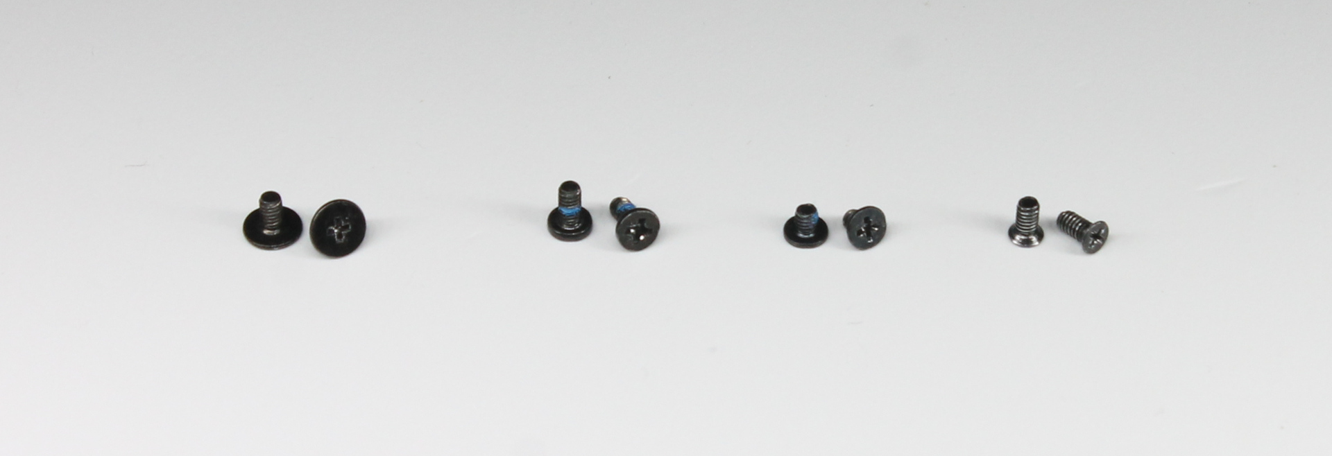

Screws#
The Librem 16 uses four types of screws:
  • 4x card screws (large wafer head), securing the three M.2 cards and the I/O board
  • 26x chassis screws (small wafer head, long shank), securing the other internal components
  • 7x mainboard screws (small wafer head, short shank), securing the mainboard and heatsink
  • 11x bottom cover screws (countersunk flat head), securing the bottom cover (D-shell)
Photo of examples of each of the four screw types
All of the Librem 16 screws are M2 coarse thread, or M2x0.40. 0.40 mm is the thread pitch.
Screws just labeled “M2” are usually this pitch. Finer pitches, like M2x0.25, are not compatible.

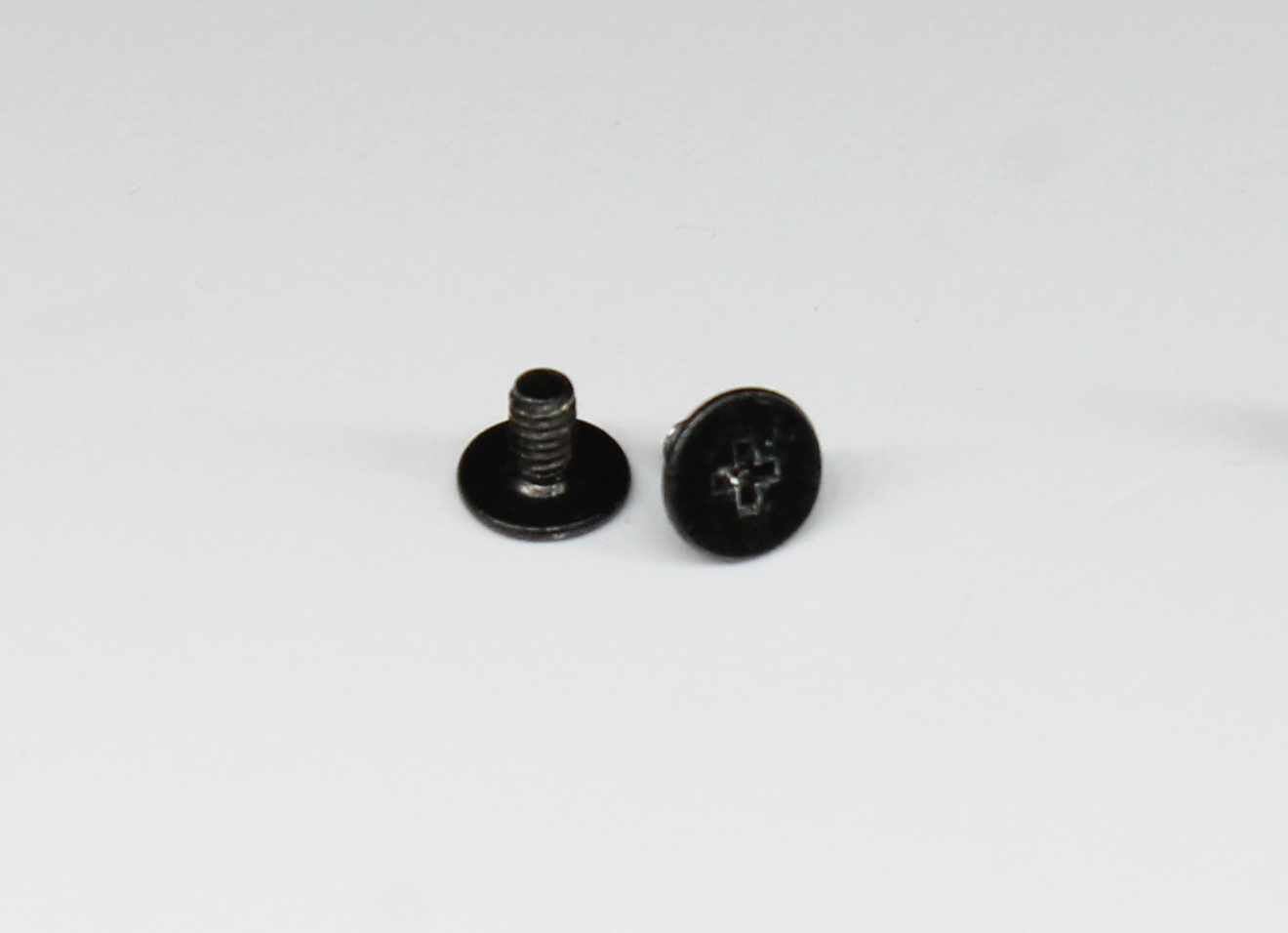

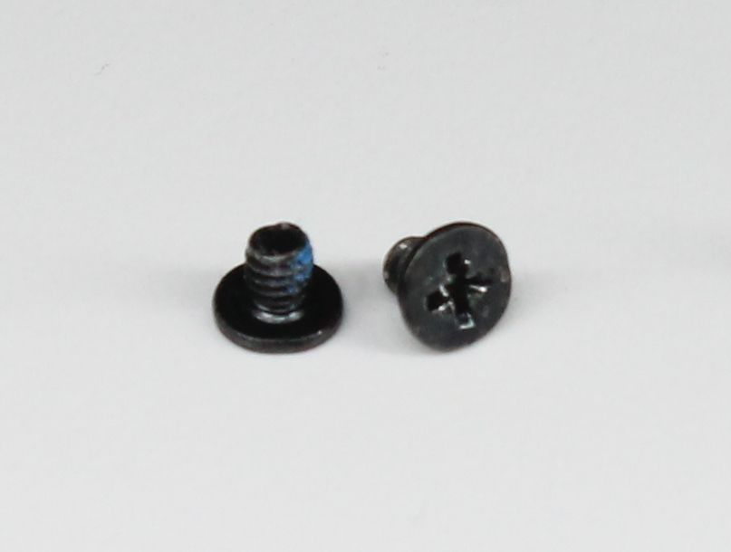

Mainboard screws#
Photo of mainboard screws
These screws secure the mainboard and heatsink.
  • Wafer head M2x0.40 machine screws
  • 3.8 mm head diameter
  • 2.5 mm shank length
  • 0.5 mm head thickness
The reduced length of these screws is important, since the mainboard is mounted close to the keyboard and C-shell.

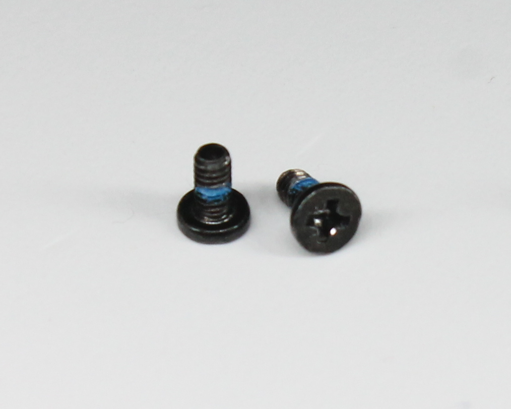

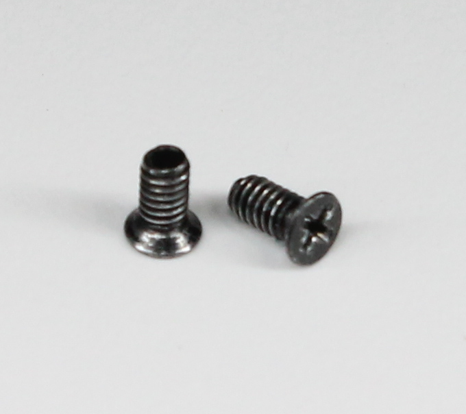

Bottom cover screws#
Photo of bottom cover screws
These screws hold the bottom cover to the chassis.
  • Countersunk flat head M2x0.40 machine screws
  • 2.9 mm head diameter
  • 3.9 mm length
The length of countersunk screws includes the screw head.

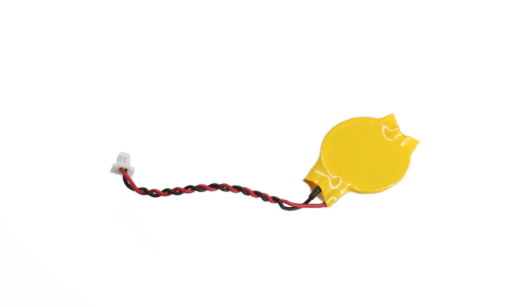

Coin cell battery#
The coin cell battery is a 3.0 V lithium primary cell (non-rechargeable). It connects with a two-pin wafer connector.
Purism ships CR2032, but any 3.0 V primary cell is compatible as long as it fits in the available space under the I/O cable. CR2032 and CR2025 are both commonly available and compatible.
Be sure the wafer connector polarity is correct, as these are not standardized. Compare to this image:
Photo of coin cell battery part
If the polarity is not correct on a third party battery, it is often possible to swap the wires. Use a craft knife to lift the plastic tab retaining each wire contact, slide out each contact, and insert them in the correct positions.

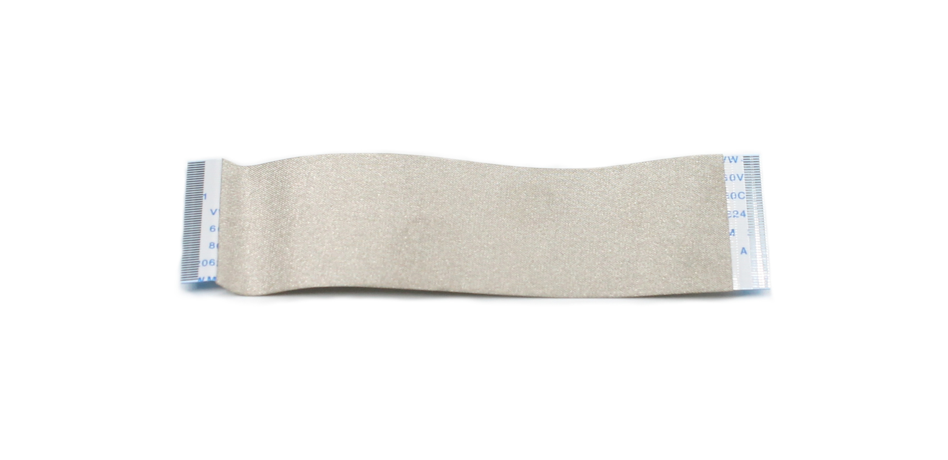

I/O cable#
The I/O cable is a shielded flexible flat cable. Shielding is important: high-speed serial links including PCI Express and USB 3.2 Gen 1 traverse this cable.
Photo of I/O cable part
  • Shielded flexible flat cable
  • 100 mm length
  • 50 positions
  • 0.5 mm pitch
  • Same side contacts
There is not much allowance in this cable’s specifications. Cables as short as 95 mm may work if installed carefully, ensuring the cable fully seats on both ends. Cables up to about 105 mm may work if installed carefully, ensuring that the cable is bent gently to accommodate the length without creasing.

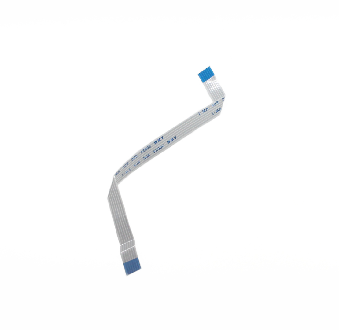

Touchpad cable#
The touchpad cable is an unshielded flexible flat cable.
Photo of touchpad cable part
  • Unshielded flexible flat cable
  • 130 mm length
  • 6 positions
  • 1.0 mm pitch
The touchpad uses a low-speed bus (I2C) and is more tolerant than the I/O board. The cable must be creased to fit under the battery - crease it once to create the proper shape, then avoid unfolding or refolding it, which will wear out the cable.
Shorter cables down to 120 mm may work if installed carefully. Longer cables may work if they are folded properly to fit in the available space.
The cable must have same-side contacts. Opposite-side contacts will result in the wrong polarity, even if the cable was folded to physically fit, and this will damage the mainboard and/or touchpad.

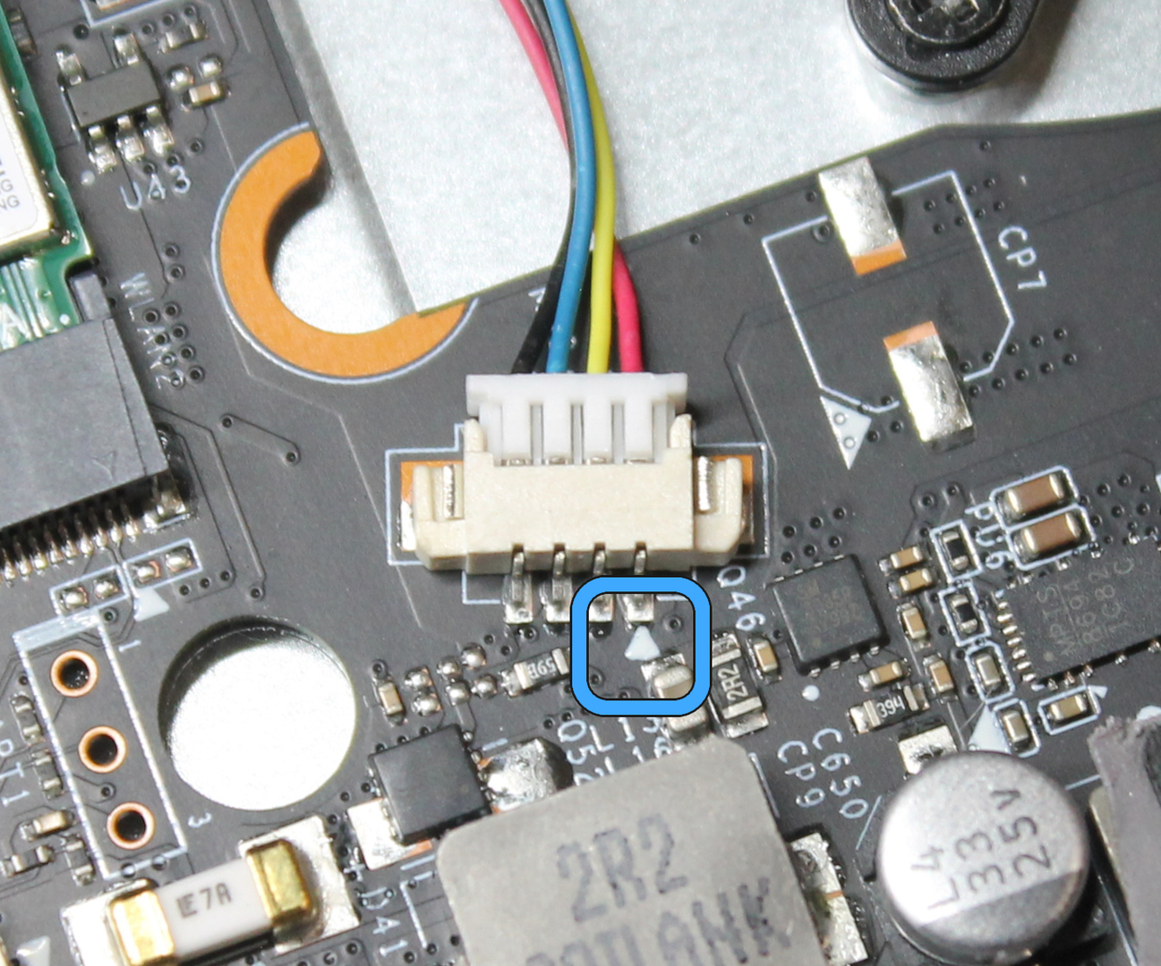

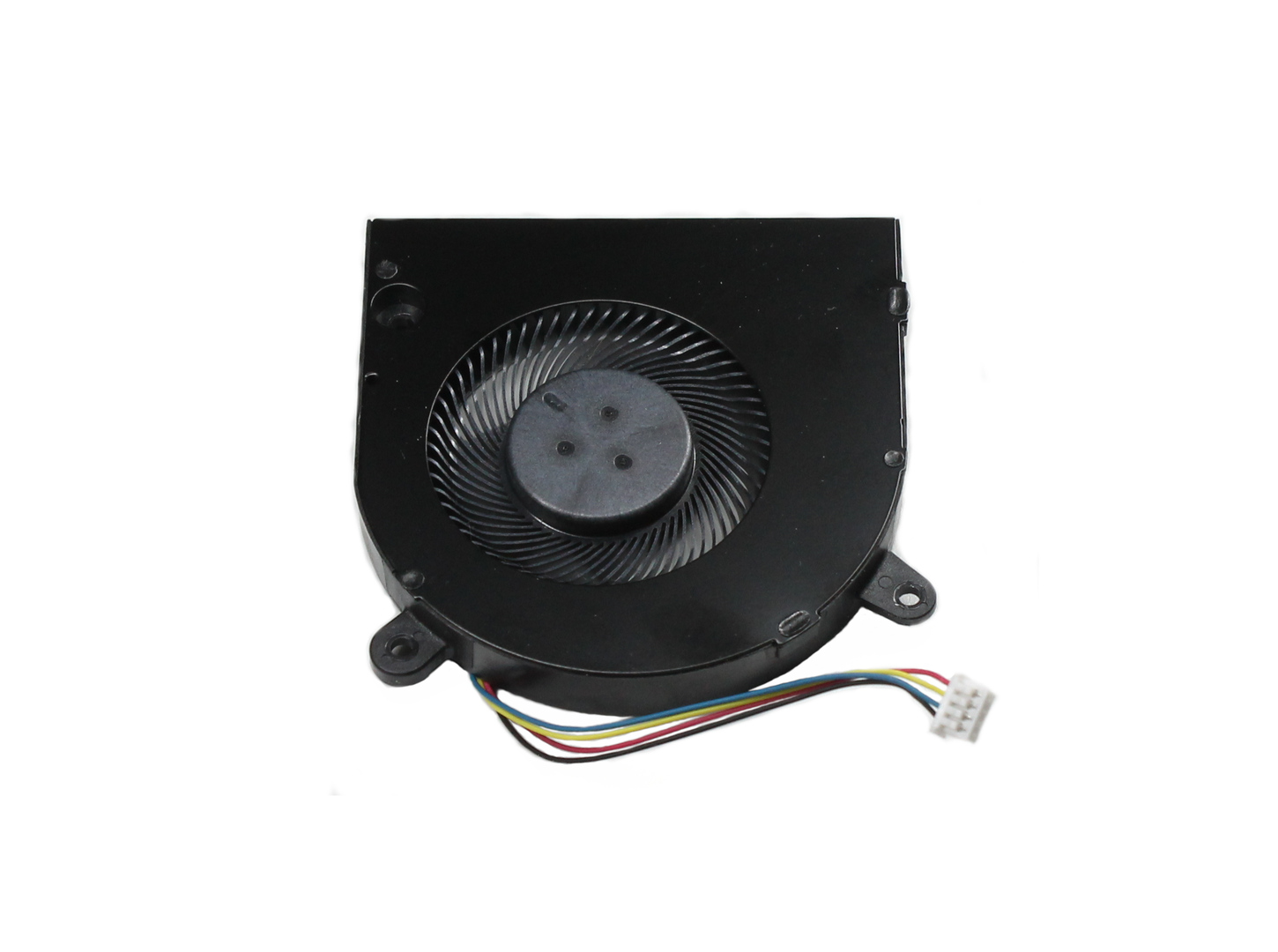

Fan#
The fans are both BroadFan BF06007H05FP. These are commonly available as parts for laptops and Mini PCs. However, be aware that OEMs can order the same fan model with different wiring. The presence of the part number BF06007H05FP does not indicate how the fan is wired.
Photo of fan
The Librem 16’s fans use 4-pin wafer connectors with pin configuration:
  1. +5V
  2. Tachometer
  3. PWM control
  4. GND
Pin 1 is marked on the mainboard with a triangle:
Photo of fan connector on mainboard, with pin 1 indicator marked
The central fan has 90 mm wiring. The outer fan has 125 mm wiring. Longer wiring can be substituted as long as it is routed properly.
